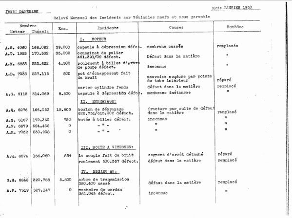

From the archive of Citroën Danemark we have found some interesting dokuments. It´s a report from Automobiles Citroën A/S Danemark to Citroën in Paris about the failures to new Citroëns. We have found reports from 1950 and 1951, and below you can see 2 samples.

Thank you, Torsten! :D Quite interesting! I thought the Tractions were always PERFECT!!! :lol: :lol: :lol:
