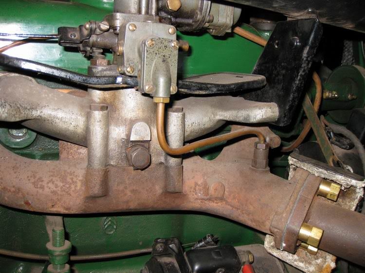

Quelqu'un pourrait-il me fournir une photo de ce carburateur installé sur la voiture avec en particulier la canalisation qui amène les gaz chauds dans le starter automatique ?

I have myself a 11 normale from 1939 under restoration. To this car I have a Solex 35 FATIP with termostarter.
You were asking to see a picture of the setup. Here it is.
The picture is not of my car but a 11 BL from 1939.

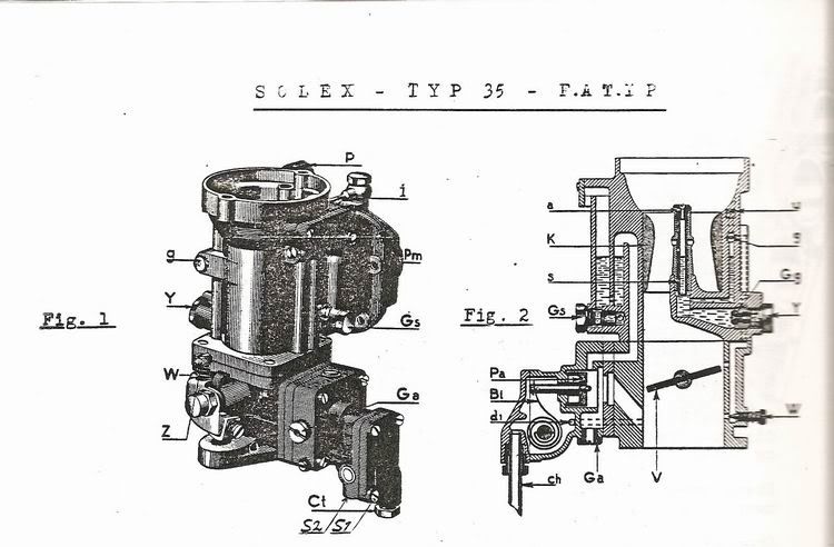

This is a drawing of the 35 FATIP showing the internal parts.
If you want to see more pictures of a Solex 35 FATIP including the termostarter in parts, please let me know.

Hi Vig, thanks for your help, and never mind for your French, it's OK in English (désolé pour le francophones, s'il y en a un qui veut la traduction, on s'arrangera !)

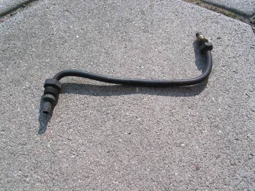

The picture is great, it's exactly what I was looking for. I don't have the pipe linking the thermostarter to the exhaust manifold but now, I know what to seek for or at least what to build.
There are two questions remaining concerning the initial adjustment of the fuel/air 'piston' (quoted 'Pa') in the assembly. Do you think it should firmly press the bolted big spacer (btw the main carb body and the 'Ga' jet on the drawing) when warm ?
Second question : at which temperature the piston is fully retracted without thermostatic spring tension (like on the drawing) leaving the fuel hole fully open ? Zero, 20 degrees (C) ?
As there is a possibility to adjust the initial postition of the piston, I need to know that before using the FATIP.

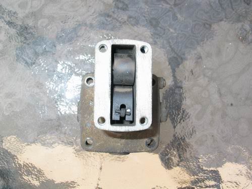

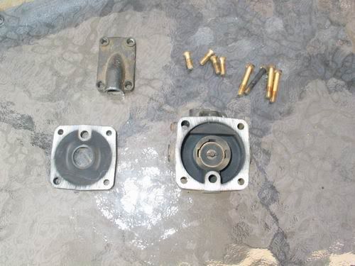

I must admid that I dont know at what temperature the valve is open or fully closed. But the manual says that the engine must run for at least 2 min. before the starter valve is closed. If it close in less that 2 min. or in more that 2 min. you can adjust the bimetal spring if you loosen the little screw S1 in the drawing, and then adjust the tension with the bigger screw S2.
Below you can see a picture of the adjustment screws.
There are also pictures of the starter in pieces.
